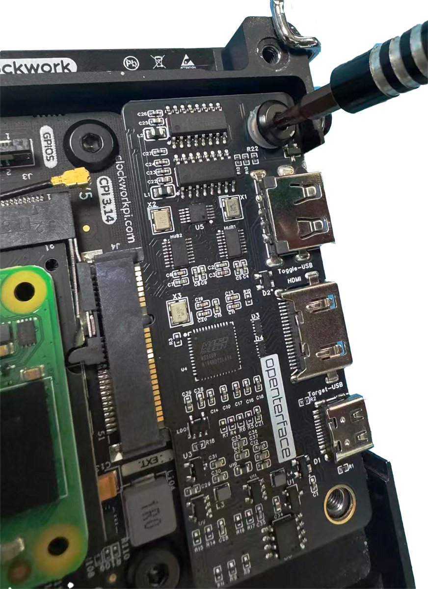

2. Remove Existing Module
Use a hex screwdriver to remove the two screws.
Lift the board straight up to avoid bending the spring contactors.

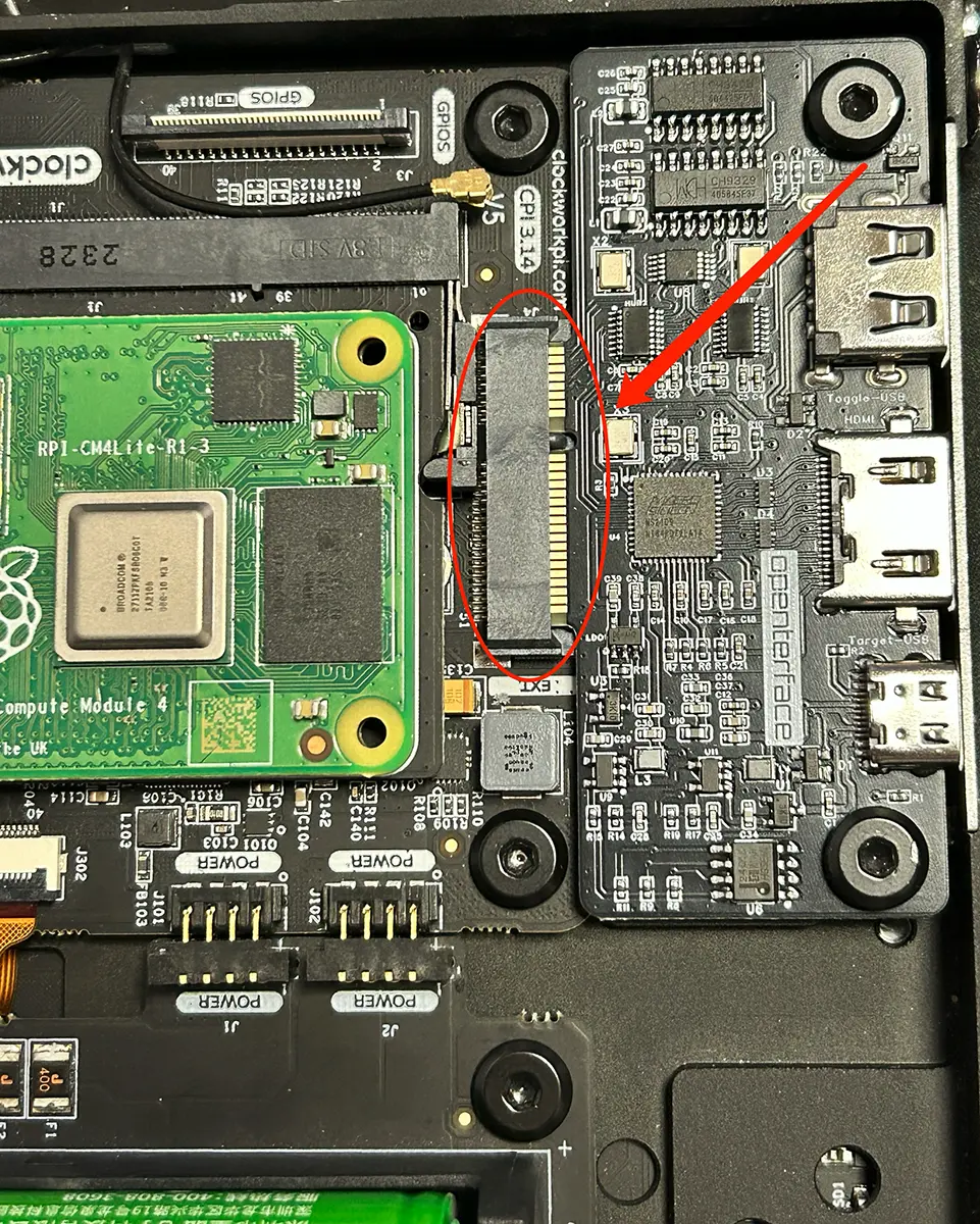

3. Install the KVM Extension

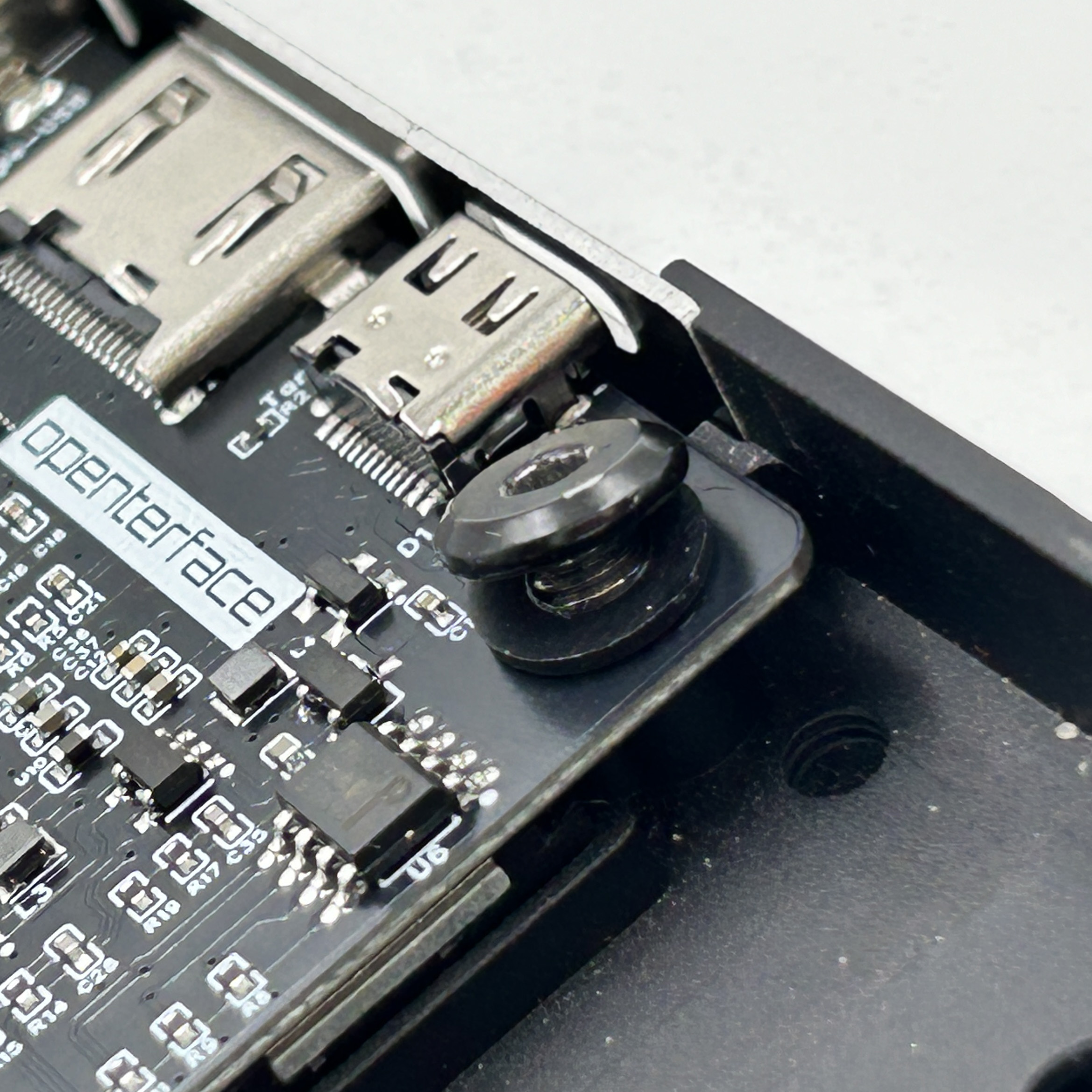

  • Place the washer on the screw post.
  • Seat the KVM Extension firmly into the expansion slot.
  • The washer compensates for the slightly thinner PCB (1.0 mm vs 1.2 mm), maintaining proper spring contact pressure.

4. Secure the Board
Reinsert screws and tighten gentlydo not overtighten, as this may damage the board or strip the threads.

5. Verify Installation
The board should sit flat and stable, with even spring contact across all pads. There should be no noticeable wobble or movement.

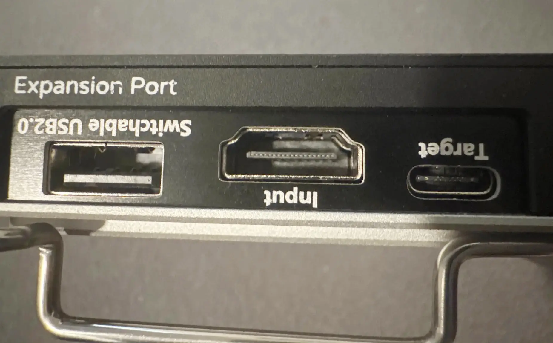

Text Orientation on Expansion Slot Cover
The text on the expansion slot cover may appear "upside down" when viewed from certain angles. This is intentional design - the text is oriented to be readable when you're holding the uConsole and looking at the ports from top to bottom, which is the natural viewing position when using the device. expansion-slot-text-orientation
