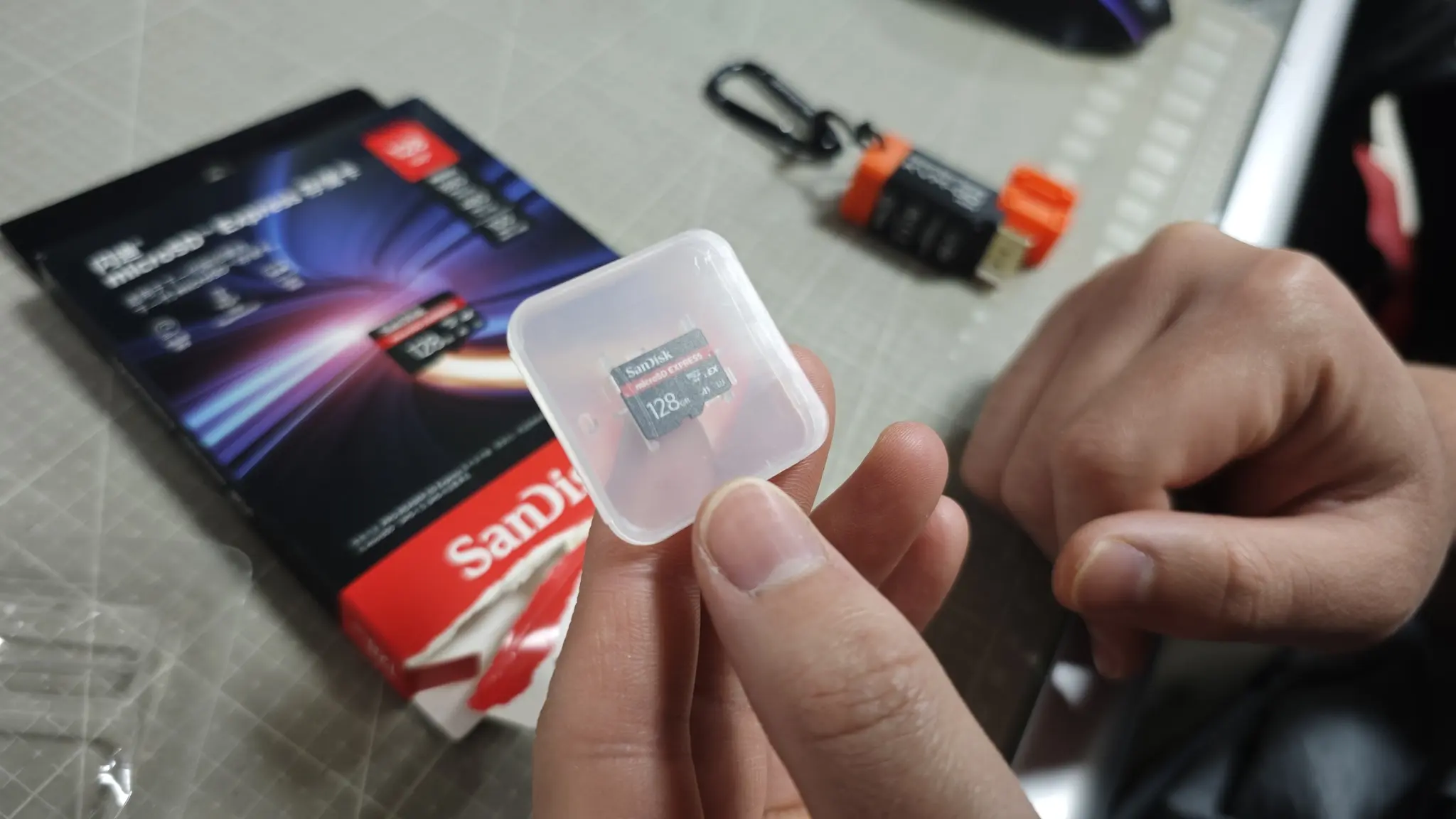

What we tested
  • Card: SanDisk microSD EXPRESS 128GB
Test card used: SanDisk microSD EXPRESS 128GB.
  • Goal: Confirm basic compatibility (detection + read/write) and measure real transfer speeds through KVM-GO's microSD path.

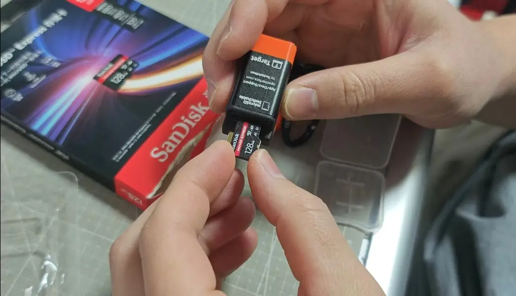

  1. Insert the microSD EXPRESS card into KVM-GO's microSD slot.
  2. On a Windows PC, copy a large folder/file set to the microSD card to observe sustained write speed.
  3. Copy data from the microSD card back to the PC to observe sustained read speed.
  4. We used normal OS file copy, and recorded the speed shown in the Windows transfer dialog.
Test setup: inserting microSD EXPRESS into KVM-GO for read/write checks.

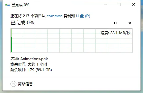

  • Write speed: around 30 MB/s
Write test (PC → microSD): ~28 MB/s observed during file copy.

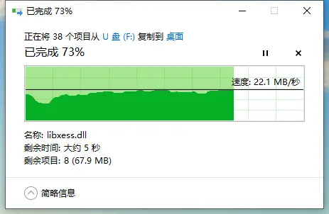

  • Read speed: around 20 MB/s
Read test (microSD → PC): ~22 MB/s observed during file copy.
These numbers can vary depending on file sizes, the mix of small vs large files, OS caching behavior, and overall workload, but this is the range we consistently saw.

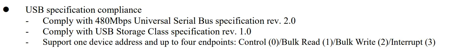

microSD EXPRESS cards are capable of much higher performance in the right setup, but KVM-GO's microSD storage path is limited by the internal bridge/controller used for microSD-to-USB storage.
In KVM-GO, that bridge operates at USB 2.0. USB 2.0 is often described as 480 Mbps (theoretical), but in real-world file transfers the sustained throughput is typically much lower due to protocol overhead and implementation details.
USB 2.0 storage path reference. The microSD storage bridge is USB 2.0 (480 Mbps theoretical). Real-world file transfer throughput is lower.
This is why microSD EXPRESS works fine on KVM-GO, but you should not expect Express-level speeds through this specific microSD path.
