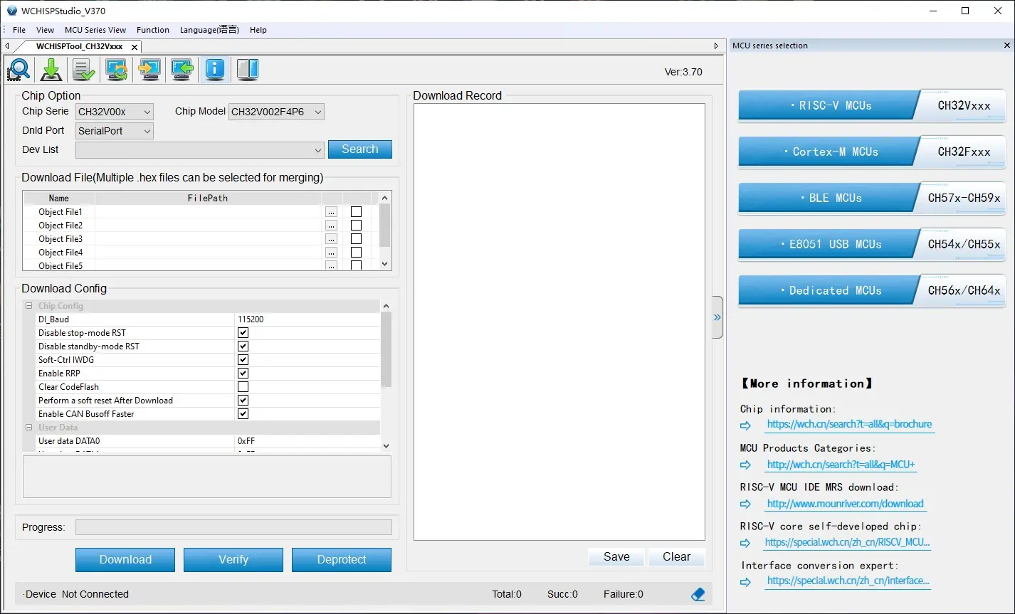

Step 1: Download and Open the Tool in Windows
Launch the WCH ISP Tool on your Windows computer.
WCH ISP Tool interface

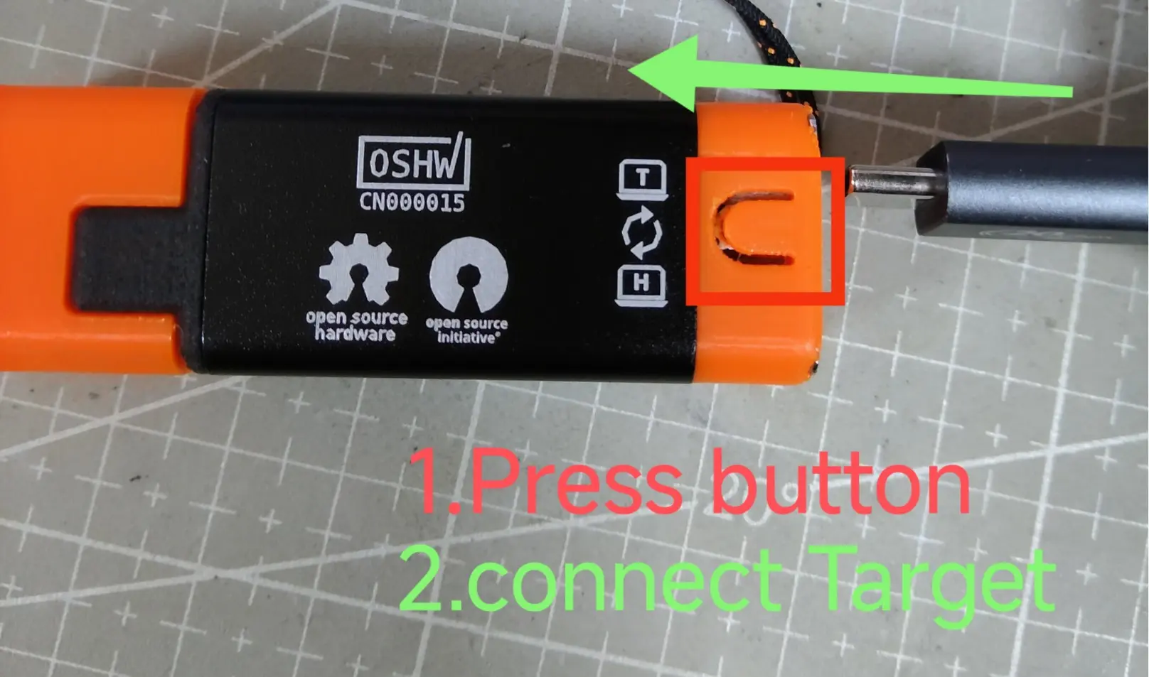

Step 2: Prepare the KVM-Go for Flashing
To flash firmware on the KVM-Go:
  1. Ensure the device is powered off
  2. Press and hold the button while connecting it to a USB Type-C port
Tip: You can flash the firmware using either port, but the "target" port tends to be more stable during flash.
KVM-Go wiring and connection setup

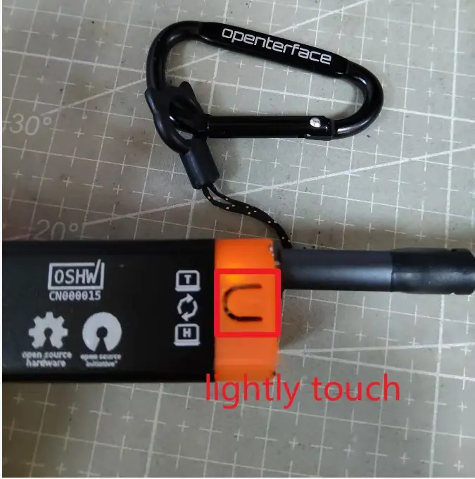

Step 4: Deprotect Current Firmware
Before flashing new firmware, you need to remove write protection from the current firmware:
  1. Click the "Deprotect" option in the tool
  2. Briefly press the physical button on the KVM-Go to enter flashing mode
  3. Wait for the deprotection process to complete
Deprotect firmware option in tool
Press button on KVM-Go to enter flashing mode

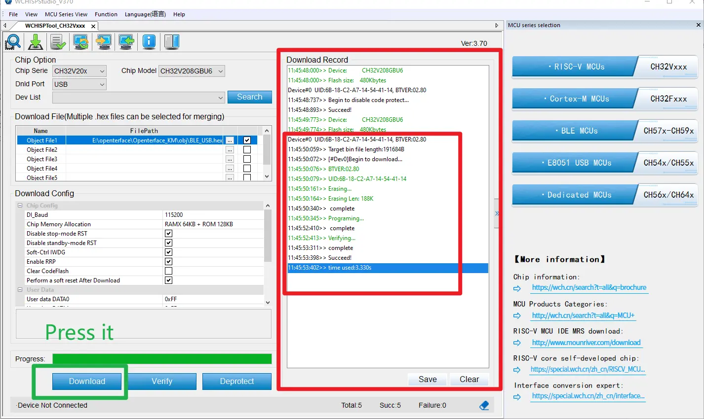

Step 5: Download and Flash the Firmware
Once the firmware is deprotected and selected:
  1. Click the "Download" button in the flashing tool
  2. Wait for the flashing process to complete
  3. The tool will indicate when the firmware has been successfully flashed
Download and flash firmware process
