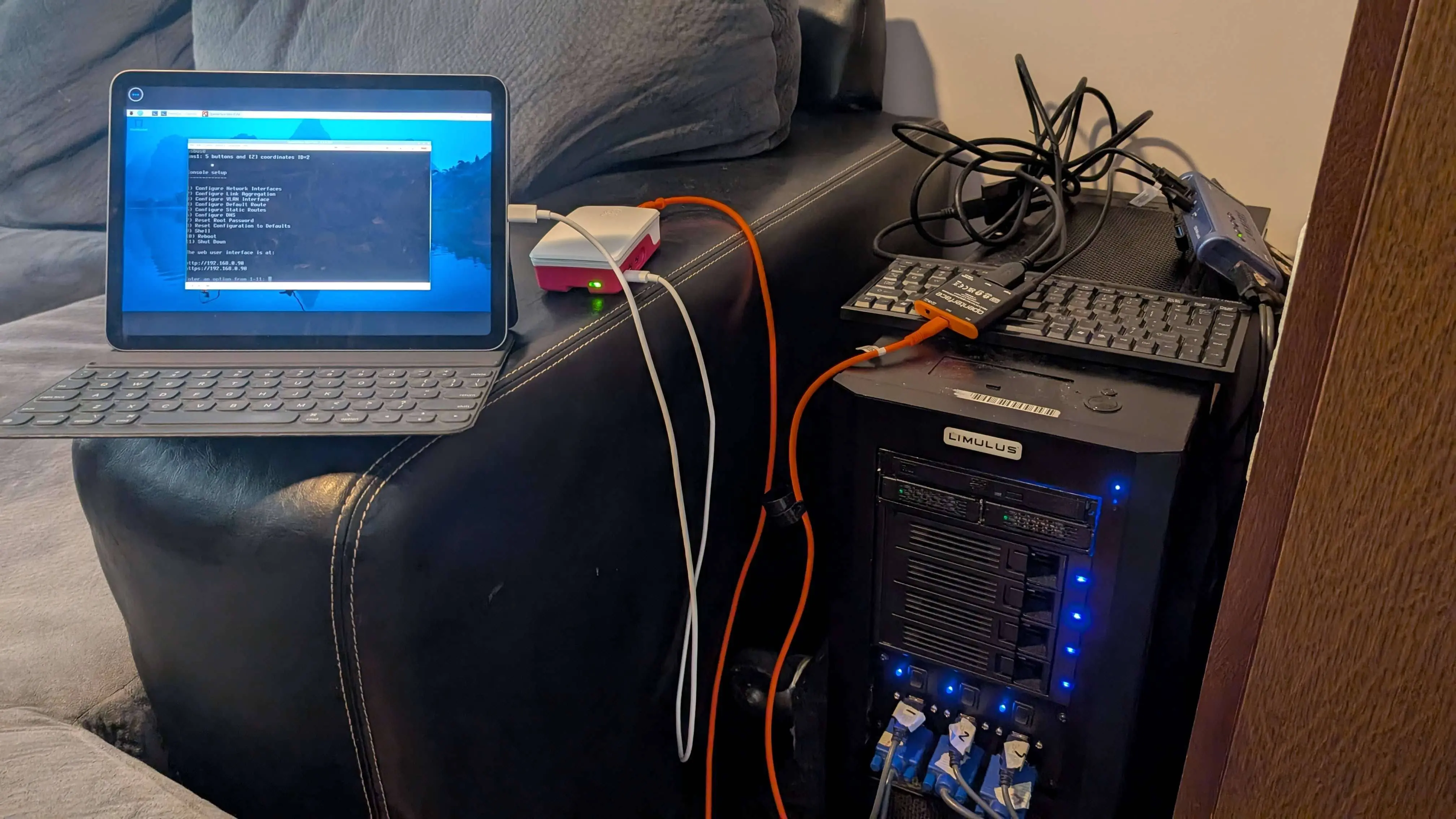

The Solution: Raspberry Pi Bridge
The project's core innovation uses a Raspberry Pi in "gadget mode" as a dual-purpose bridge:
  1. Draws Power
    • Pi's USB-C port is configured to pull 5 V directly from the iPad
  2. Carries IP Traffic
    • Internal network bridge carries IP packets over the same USB-C cable
  3. Serves VNC
    • VNC server on the Pi allows direct remote desktop on the iPad,no Wi-Fi required
  4. Drives KVM
    • OpenterfaceQT on the Pi interfaces with the Mini-KVM hardware
    • iPad's VNC session streams video and sends keyboard/mouse events to any target computer
Implementation Details
  1. Raspberry Pi Configuration
    • Enable gadget mode in /boot/config.txt and /etc/modules
    • Configure USB-C for 5 V power delivery
    • Establish network bridge with static IP (10.55.0.1)
  2. Remote Desktop Setup
    • Install and configure x11vnc on the Pi
    • Auto-start VNC server on the bridge interface
    • On the iPad, connect with a VNC client (e.g., RNC Viewer) to 10.55.0.1 or pi.local
  3. Mini-KVM Integration
    • Compile OpenterfaceQT for ARM architecture
    • Plug Mini-KVM into the Pi's USB and HDMI ports
    • Power the Pi via its USB-C port
  4. Operation
    • Connect the Pi to the iPad using a single USB-C cable
    • Launch the VNC client and authenticate
    • Open the Mini-KVM interface on the Pi
    • Stream the target device's video feed and control it in real time
System Architecture
Standalone KVM Setup
Components
  • iPad (Host): VNC client and power source
  • Raspberry Pi 5: USB gadget, network bridge, and OpenterfaceQT host
  • Openterface Mini-KVM: Hardware interface for target computers
  • Connectivity: USB-C (power + network), HDMI, and USB-A cables
Impact and Accessibility
With just an iPad, a Pi, and a Mini-KVM, Casey turned everyday tablets into BIOS-level consoles, no extra gear or network needed. This solution operates entirely on iPad battery power, requires no external power or internet, and remains highly portable for field use. Casey's detailed documentation and build scripts make this approach accessible to anyone with a Raspberry Pi and an iPad.

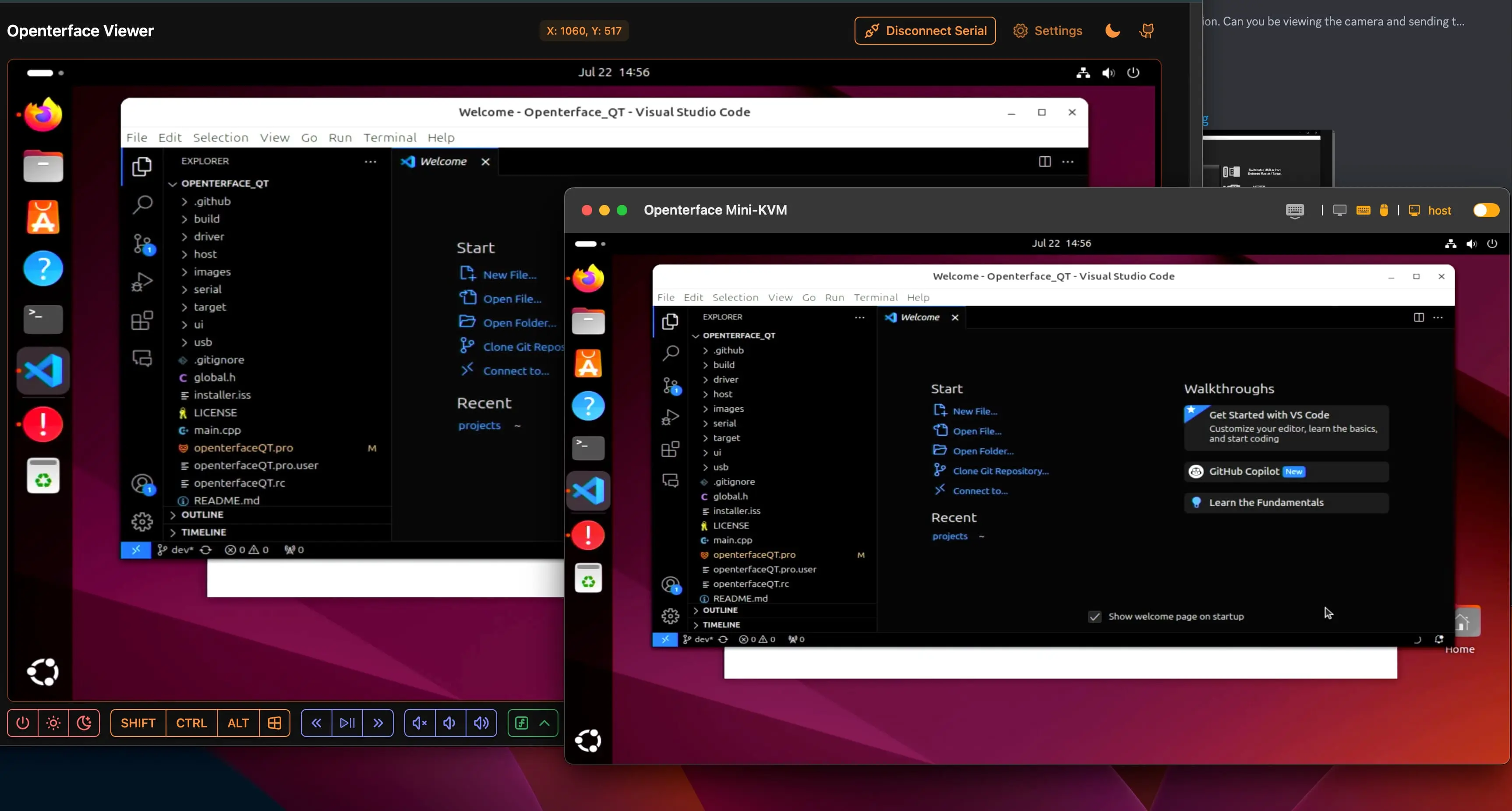

Kashall’s Openterface Viewer is a standout entry in the USB-KVM DIY Challenge 2024, offering a lightweight, open-source alternative to the Openterface_QT desktop application. This browser-based KVM interface runs entirely client-side in Chromium-based browsers and requires no installation or backend server. Designed for use with the Openterface Mini-KVM, it’s built on emerging web standards like WebUSB, WebSerial, and WebHID to provide a portable solution for managing headless devices.
Screenshot of Openterface Viewer Web Interface showing the browser-based control panel Screenshot of Openterface Viewer in action controlling a target device
