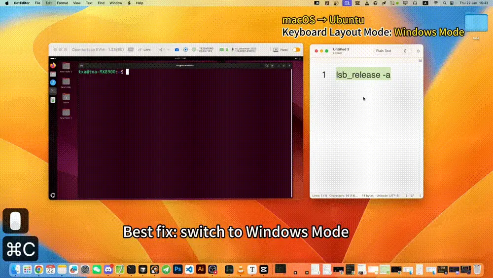

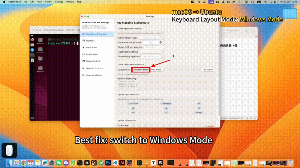

  1. Open Openterface on macOS.
  2. Go to Settings.
  3. Find Target device keyboard layout mode.
  4. Select Windows Mode.
win-mode
✅ Result: Paste shortcuts behave as expected on Ubuntu (Ctrl-style behavior).

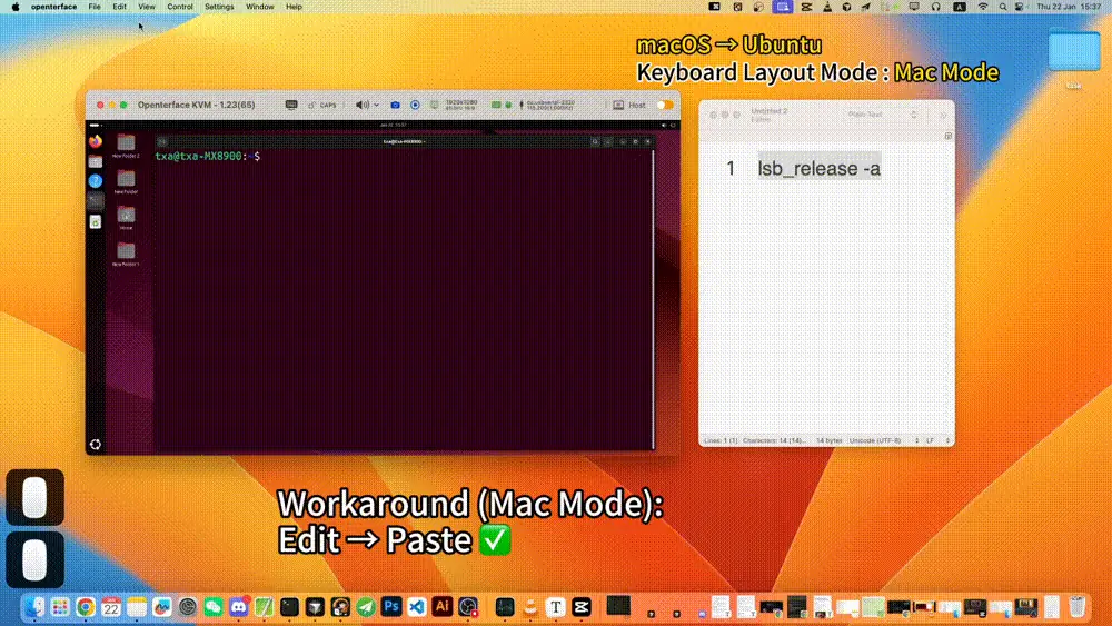

Workaround (If you want to stay in Mac Mode)
If you prefer to keep Mac Mode, you can still paste reliably using the menu:
  • Edit → Paste
edit-paste
✅ Result: Pasting works even if shortcut paste is inconsistent in Mac Mode.

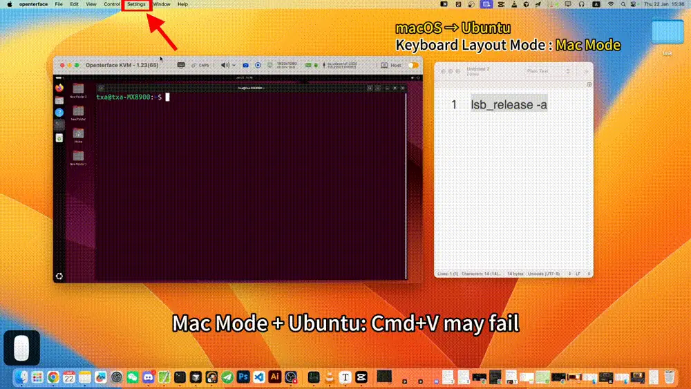

Why this happens
Most Ubuntu apps use Ctrl-based shortcuts for paste. In some setups, Mac Mode shortcut mapping may not trigger paste consistently, while Edit → Paste works reliably.
